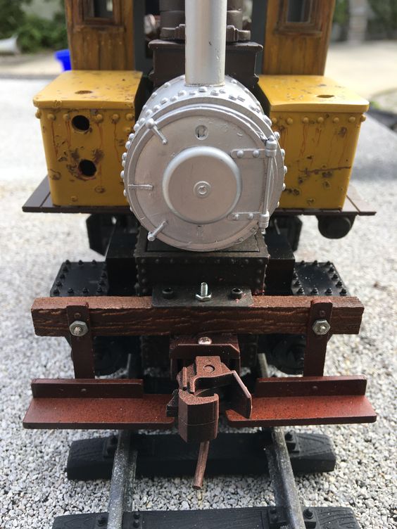

Little more done today, got the cribbing for the wood box finished, painted and installed, but most the time was spent on figuring type, location and mounting of the front coupler. Luckily I found in my collection of Kadee couplers a centerset short gear box # 835 couple which enabled me to mount it to a wood beam and both secured to a small flat protruding plate that is on 2010 engines, there were some angled supports molded in underneath which I had to remove but a sharp chisel made short work of them. The wood beam is actually PVC board that I had ripped sometime ago to make supports for my water tower. The wantabe cow catcher is one left over from a Bachmann Big hauler tender that has excellent forgiveness in the crash department and is great for bending without breakage and gives the build the appearance of a working yard engine. I then secured every thing with 2/56 screws and nuts which can be seen in the picture as silvery dots but will get covered with grimy paint soon. Still trying to find a suitable material to make my canvas roof with, suggestion are welcome. Will post when further achievements are made, Bill

Not sure this would look like canvas, but you might try the fabric from an old pair of panty hose.
Stretch a length of it over the roof, actually securing the fabric under the base of the cab. Paint with a white glue, like Elmer's. Once the glue sets, trim with an eXacto knife and paint. Just a thought. May want to try it on some scrap first.

Calico works well, can be weathered in a number of ways. White glue works well to stiffen into position. I use it to represent tarpaulins, awnings, roofing, etc.

After several good suggestions from several readers, I found some material that my wife had that had a nice weave and was thin enough to show the groves that I had scribed in the top. Selecting a suitable sized piece I glued it with some titebond glue and allowed to dry. I was going to dye the material with coffee or tea but it had a print on it so I wound up painting it and will probably put some tar patches on it where a ember from the stack landed and caused a burn hole. still more to come, Bill
