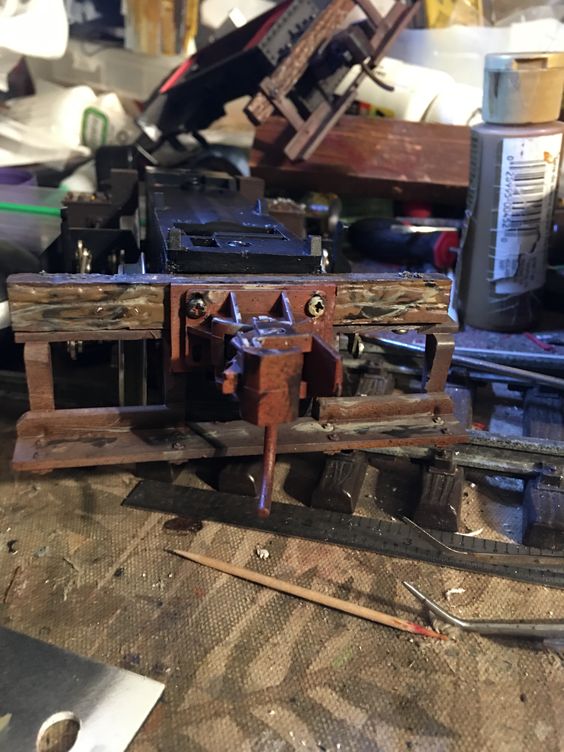

Got a little more done today been tuff cause I'm taking meds for a lung infection and so now I shake more than usual, the Kadee springs were a blast to do. Used my last beam of cut down PVC board from the pillars of my water tower for the rear beam, found a step in my junk collection off a aristo slope back tender and a new Kadee #779 coupler. Being as there is no rear section left on the engine deck, cut it off some time ago, I mounted the beam, coupler assy to the motor block using 2/56 screws taped into the housing and secured with lock tight. Hopefully the meds will be over soon and I can get to some finish assy and wiring, now looking for a usable motor to make it run, more to come , Bill

The locomotive is really shaping up. I ran into a similar problem trying to mount the coal bunker from the Aristo 0-4-0 to an LGB Porter. As I remember, I used some Plastruct I beams and LOTS of epoxy.
Fortunately, the coupler mounted rather easily to the coal bunker.

Yes it is a much needed product didn't even know it was available till about 2 weeks ago, thanks for your share like your porter looks good with the now present coal bunker, Bill
